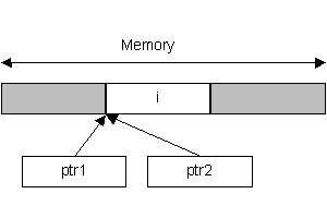

In the diagram on the right both pointers are pointing at i, and therefore a test for equality will therefore succeed. Note also that if you change the thing that ptr1 is pointing at, the thing that ptr2 points at changes as well!
Two pointers can point at the same location
